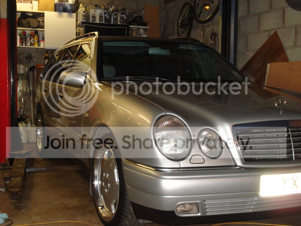

W210 model always looks good with amg wheels on.

i love those AMG wheels on the 210. cant afford any for mine at the moment though. very little work for me and money is very tight!

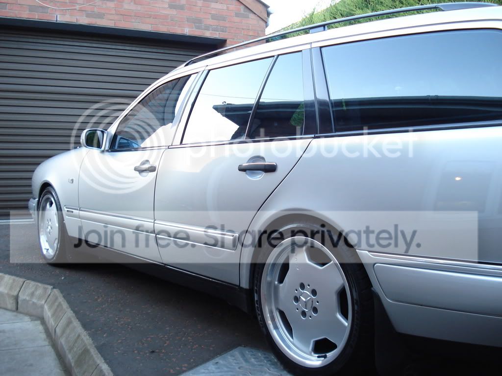

Hi
Here is a couple of snaps of my 210 with 18"AMG's
230K

sweet! theyre the ones! looks amazing! are they 18's or 19's? ive never looked hard enough at them, i just know when i can afford it, i want some for mine!!!!!! :cry::mrgreen::cry:
Hi
They are 18" staggered set up, 235/40/18 on front and 265/35/18 on rear.
