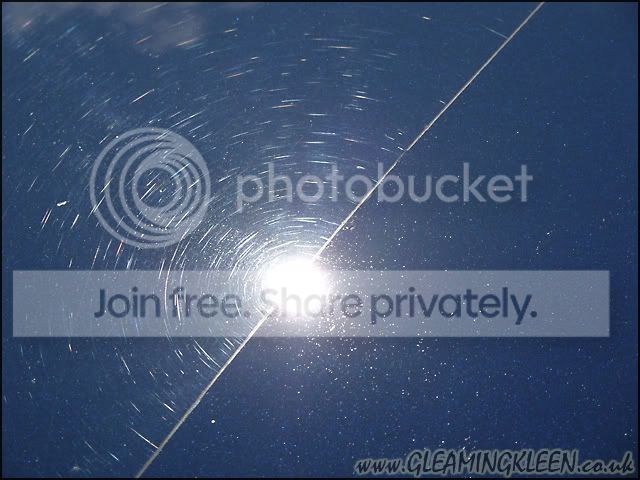

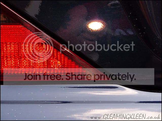

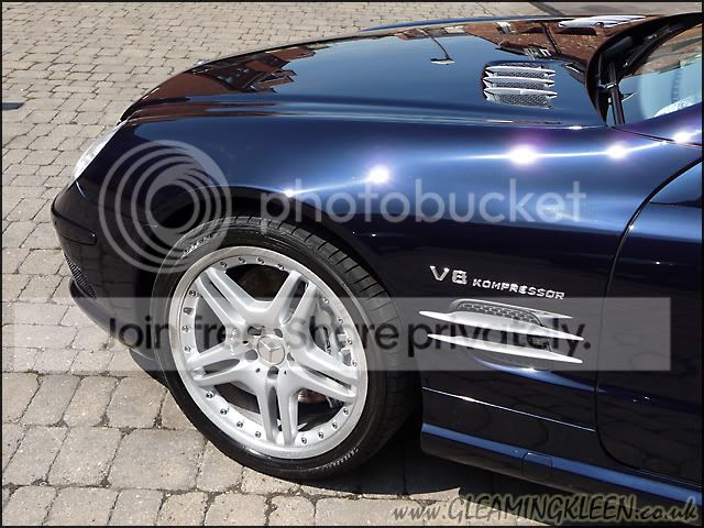

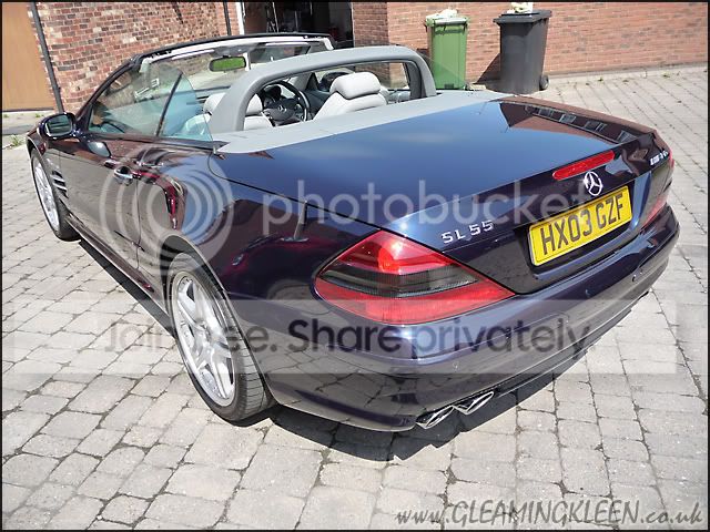

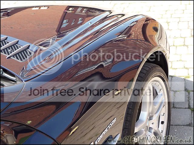

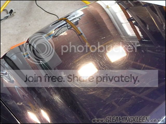

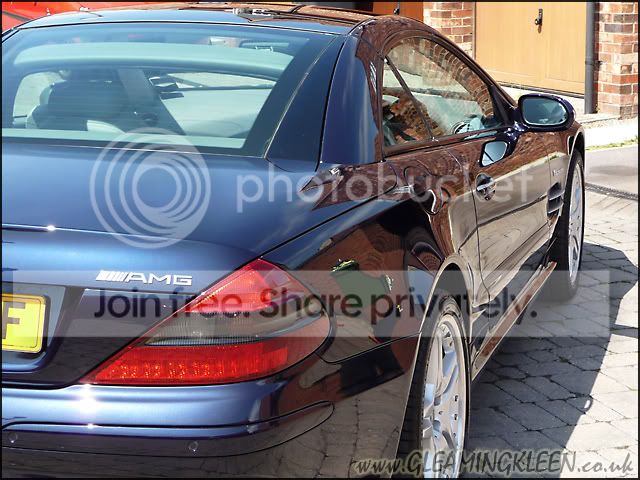

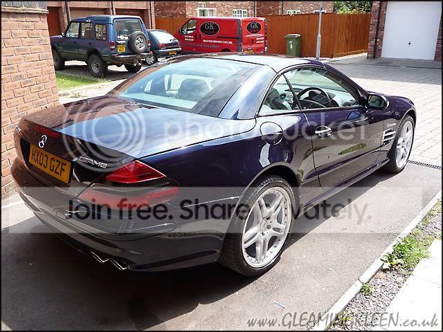

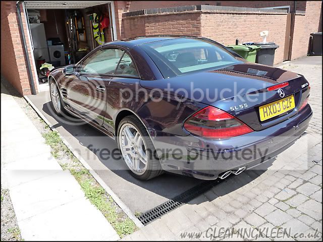

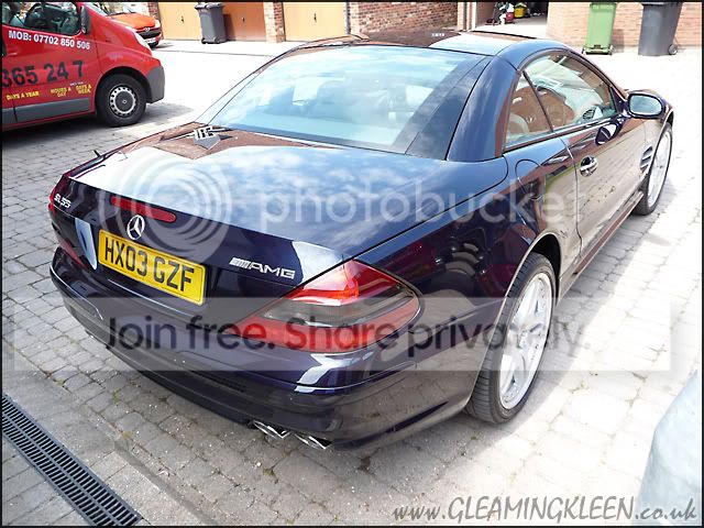

Just thought Id share some pics of a few Mercs detailed.
50/50
BEFORE
AFTER
BEFORE
AFTER
BEFORE
AFTER

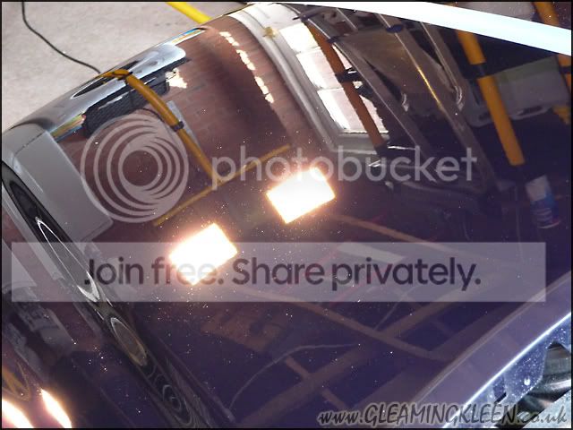

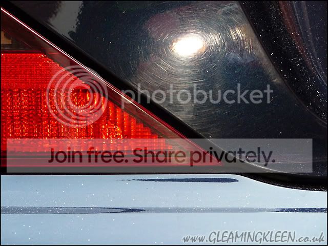

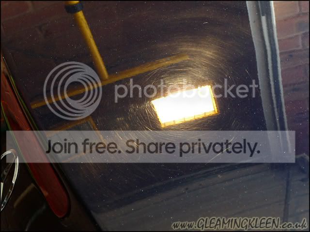

Helen, to get a finish as such it involves re-leveling the clear coat so all swirl marks, etching and scratches are removed which is done by machine polishing.
Care has to be takn that there is enough clear coat othewrwise some defects have to remain behind. Clear coat thickness is determined by using a paint thickness gauge that measures the individual layers (primer, base colour and clear coat)
