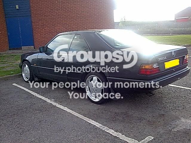

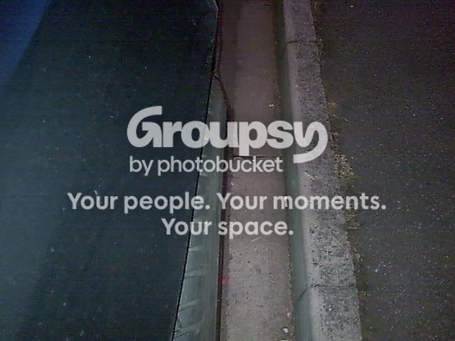

how it looks atm - others to follow to give better idea
B
B1GCC
Guest
rears are fine

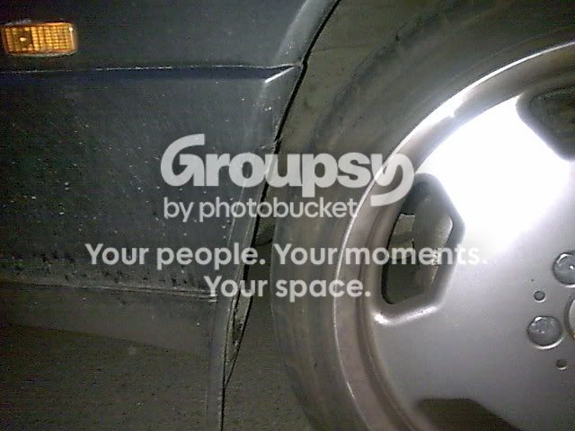

passenger front

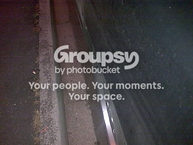

passenger front clearance, is more than driver side

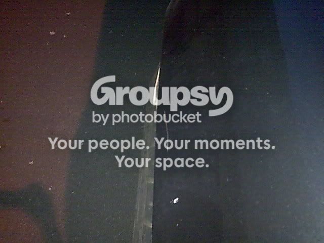

driver side clearance is poor

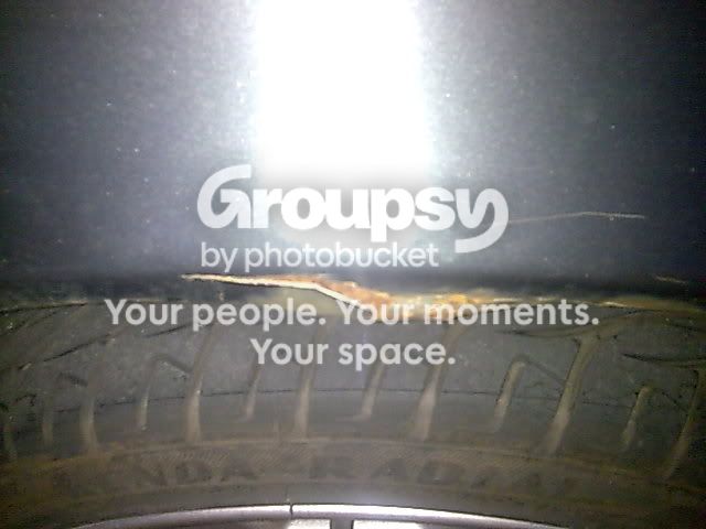

the damage already done on driver side

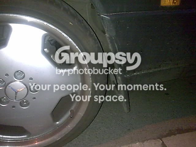

sticks out way too far

It might be an optical illusion but is the dish the same on the front and rear wheels? If these AMG wheels were bought as a set, as they normally have wider rear wheels than the front, and it "looks" like the front wheels are on the rear and vica-versa, hence my question regarding the size of the dish.
bigasotonuk
Nov 14, 2006
5,331
59
58
Southampton UK
C43/55 AMG 1999 / C230K 1997
IIRC the AMG 18" rims should be 9.5J on the rear and 8.5J on the front it might be worth looking to see if you have a set of all one type (if theres no difference in the dish that is)

Difference between front sides could be due to broken spring.

What are the wheels sizes? Width & Offset? What are the tyre sizes? How thick are the front spacers?

these wheels are too big. sell them on ebay and fit a nice set of proper sized alloys that look correct for the car. sorry but it looks pretty "barry" to me!

it looks like one side has had some work done on the suspension & not set up after by adjusting the camber & castor angle

fronts are definately wrong!!! im assuming the fronts are the problem? they look like rear wheels to me, as someone said earlier!!
