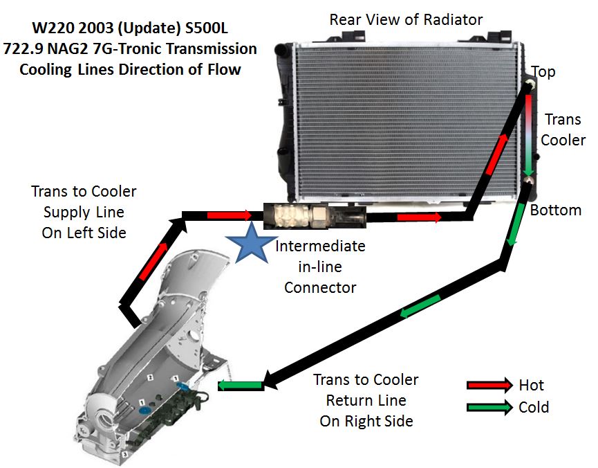

Hi guys i have a mercedes W220 (S350)
Ive recently noticed that my transmission was acting weird, in terms of gears shifting feeling a bit gerky and taking longer to shift. Ive checked my transmission fluid level and there is oil in it. Ive also noticed that there is anti freeze liquid from the engine coolant in the transmission when using the transmission stick to see the level of oil in it. So speaking to my uncle who's a mechanic, he is telling me that the engine coolant which is now showing oil is probably the transmission fluid and is most likely due to the radiator. So i wanted to find out what is causing this and also wanted to know if its water that is flowing from the radiator to the transmission or if its oil from the radiator that circulating. Ive attached a picture on what i found online and wanted to know if its water that circulates or oil?
can anyone help

It sounds like you have unfortunately fallen for the Valeo radiator problem where the coolant line has allowed the transmission to become contaminated.
You need a good indy read the current gearbox ECU fault codes to confirm, then drop the transmission pan, drain the fluid and probably replace the torque convertor as the clutch plates in side the torque convertor will be ruined.
You'll need a new radiator too.

As above.
Oil circulates from the gearbox through a heat exchanger in the radiator. That heat exchanger is leaking and allowing coolant and oil to mix so will require a new radiator.
The active ingredients in antifreeze create serious damage to the components in the gearbox starting with the torque converter. If left there may be more serious damage deeper in the gearbox.
