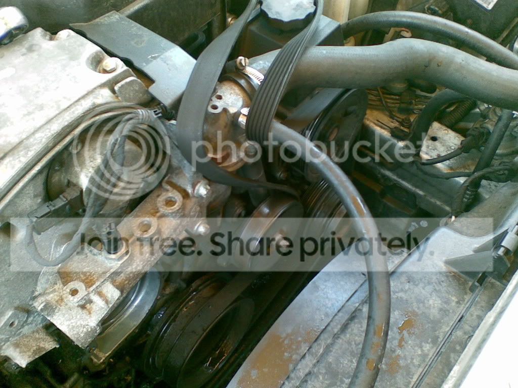

remove your fan belt. on mine you put a torx drive on the end of the tensioner pulley and pull it back on its spring. i didnt remove it entirely and looped it over the power steering reservoir [see photo]

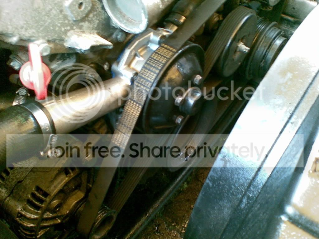

then once you have that off, and the pulley that you loosened the 4 bolts on removed, you can get to the pump.

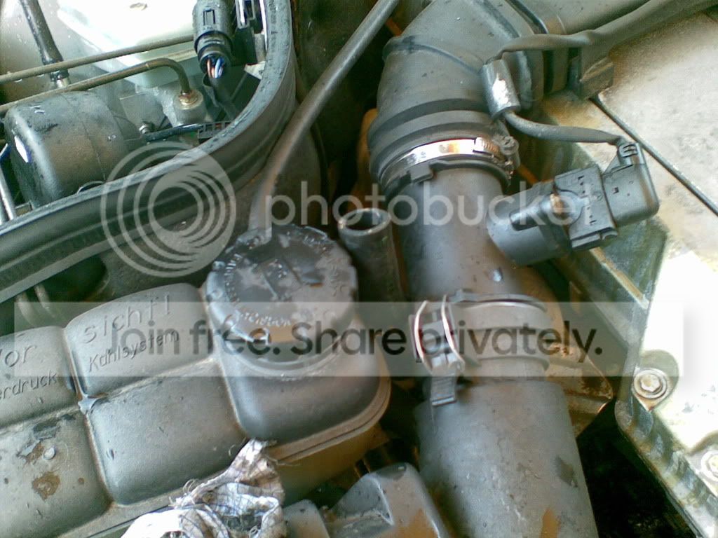

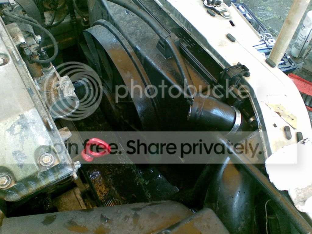

remove the hoses for the waterpump by loosening the jubilee clips. i always use a 5mm and 7mm socket rather than a screwdriver on these. note when they are loose and leaking twist them behind something suitable as shown in the pictures:

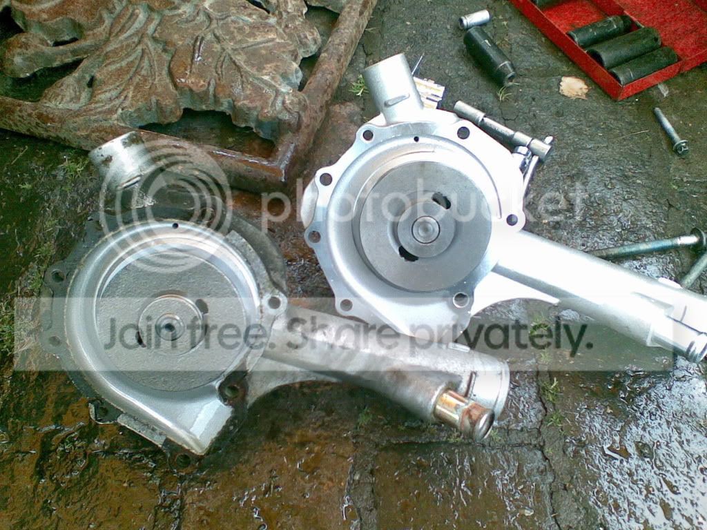

once they are removed, you should be able to crack the pump off by grabbing the big extened pipe thing and twisting/pulling it off. it will come off very easily. after its off, you should be able to see the condition of the impeller. mine wasnt too bad, it looked like new but had a bit of a squeak on it. directly comparing the GSF one to the old one i coudlnt see an immense amount of difference in quality at all tbh. see pic:

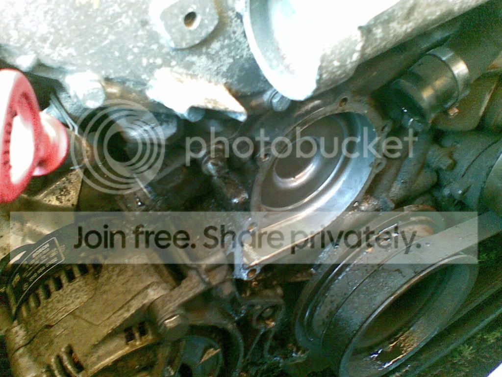

before putting the new one on, make sure you remove all the residual gasket off the engine block using the stanley knife blade. it should look like this:
