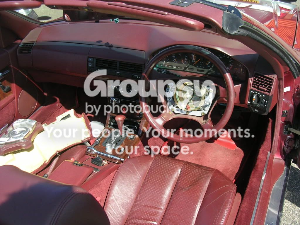

So 1st I removed the lower carpeted cover piece by unscrewing the 3 screws along the top which are well hidded and 3 right underneath in the footwell.This was easy peasy tho as I found out not essential to get at the stalk unit in the column.Then I unscrewed the 2 torque screws at the back of the steering wheel to release the centre airbag piece of the wheel.
With the centre piece unscrewed I removed the airbag wire(make sure the ignition is off when doing this) to reveal the main nut which holds the wheel on,this is removed with a big alankey and lots of strength.

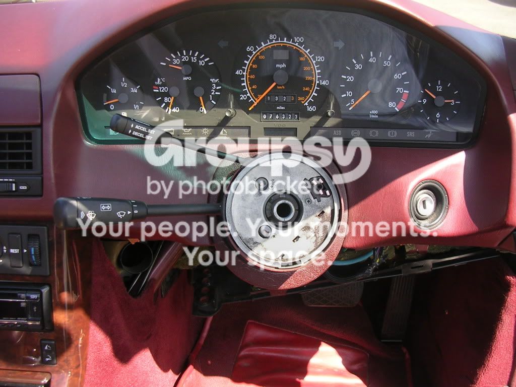

With the steering wheel removed I then had to unscrew 3 small screws which were securing a sort of metal centre plate(not sure what it called).

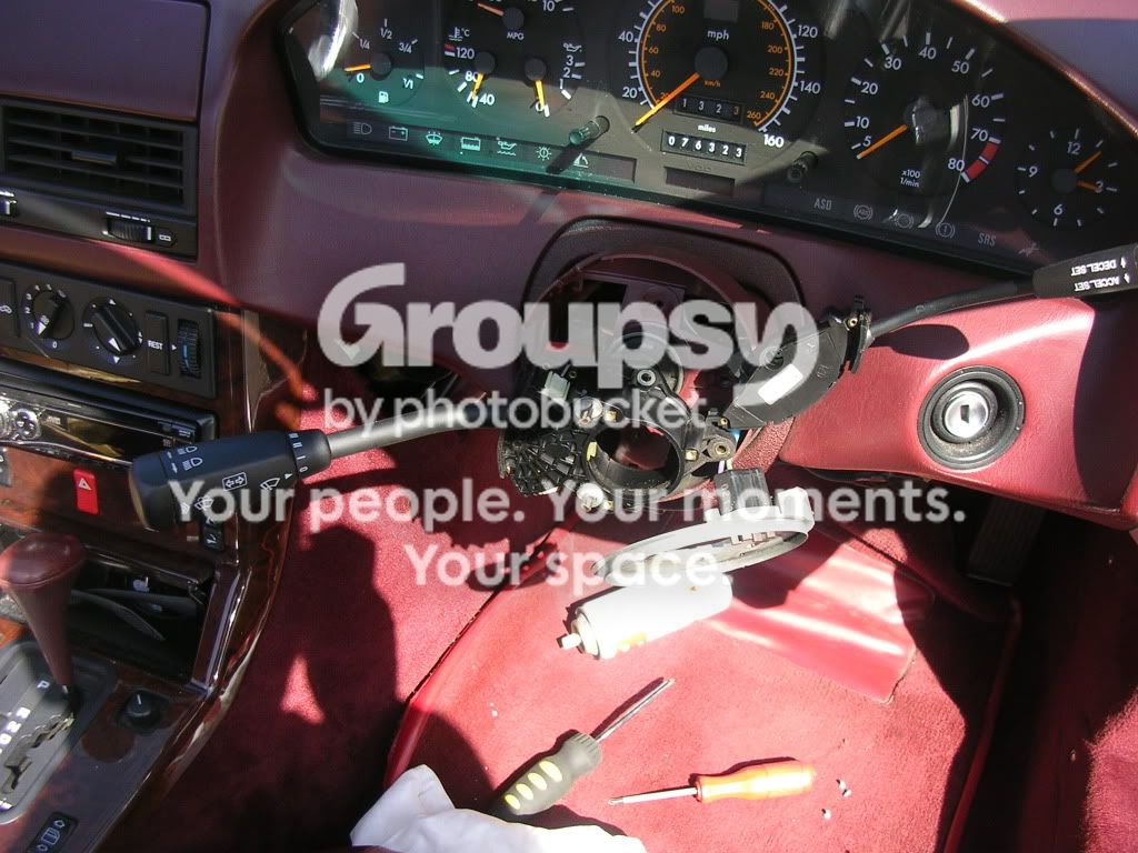

With the plate removed the innards of the steering column are revealed and 3 screws to release the wiper/indicator stalk and the cruise stalk.The cruise stalk slides out 1st and then the wiper/indicator stalk slides out.
The thing that surprised me the most was how dirty it was in the steering wheel,every stage there was plenty thick black dust to be removed.I actually used a small powerfull hand held vacuum to remove as I didn't want it going anywhere else.After I got rid of the dust I then sprayed all the contacts and even sprayed inside the stalk unit using the straw adapter of the contact cleaner.

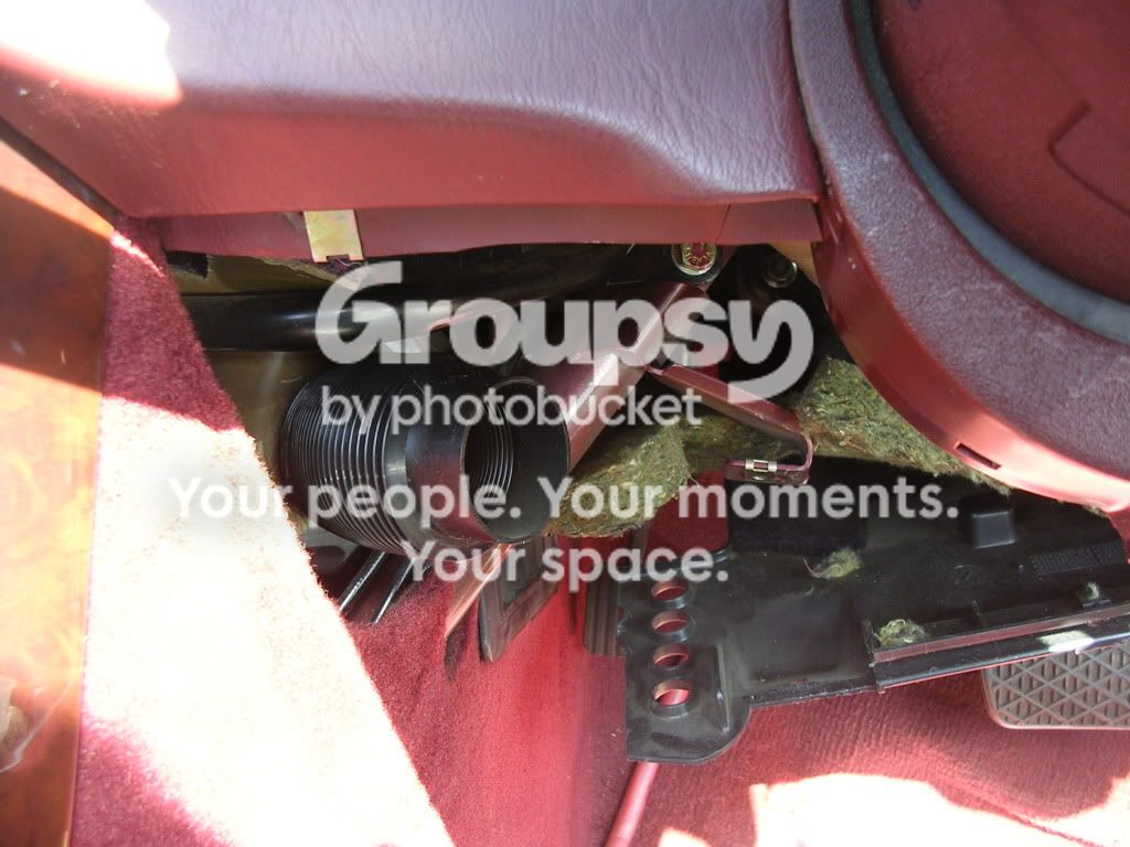

Put it all back together which was easy enough except for this pipe which was a nightmare to get back on:

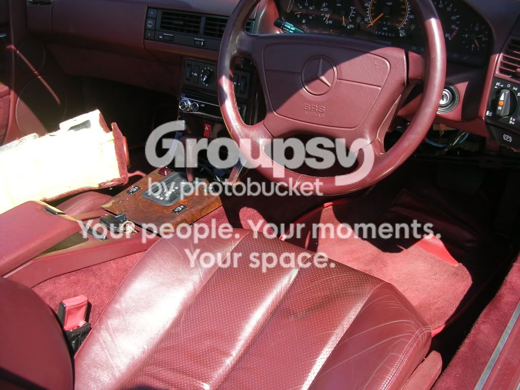

After I managed to get the pipe back on securely and tidied everything up I fired her up and woo hoo wipers,indicators and full beam all worked.
