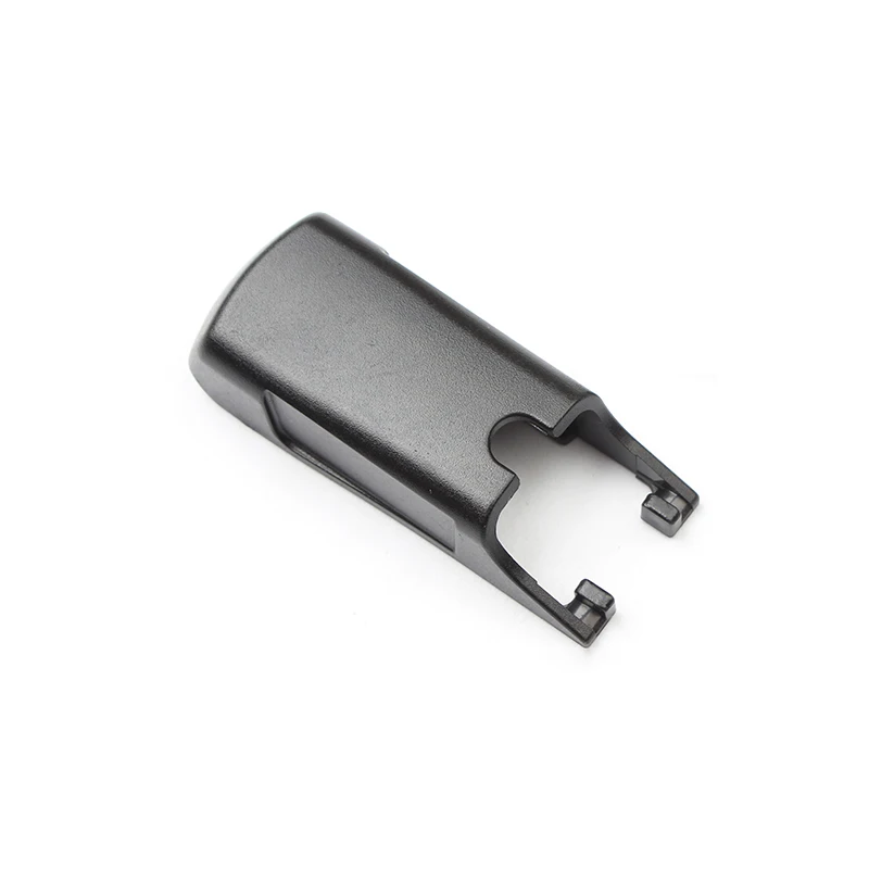

Hi Guys,
Has anyone ever managed to source these adapters?
I'm referring to what looks like a 50cent piece of plastic that connects the wiper arm to the blade.
Blue piece of plastic in the pic but generally speaking is black.
Both of these clips are broken on my wiper arms, suspect by a vandal.
MB tell me I need to replace entire wiper arms on both sides.
The service manager said this was indefensible but alas is unable to order the adapters alone.
Resigned to skulking around breakers yard with a plastic pry toll as I doubt they will sell them either.
Any ideas?
Thanks

Adapter arms arrived from China today, couple of things.
They took a month to get here, turns out the slow boat is still à thing.
`No discernable difference between them and the originals.
Wasn't sure when ordering if I was getting a pair or one, ordered two and got two individual adapters.
They fit perfectly on the arm and hold the blades in place as intended.
Top adapter is the original broken one, bottom is the replacement.
