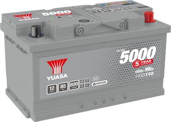

Yesterday morning I got in the S204 to go to Southampton West Quays shopping centre to find the battery totally dead, reading 7.8v after using it a couple of days previously to do a 70 mile round trip. I had noticed the start up wasn't as brisk as expected and did think the battery was suspect. So it let me down as expected.
Being short on time, I needed a replacement quickly and couldn't source a Varta or Bosch immediately. This left me with a Yuasa 5000 battery 85Ah, 800 Amp with 5yrs guarantee for £120 from Halfordso_O. Not my usual venue for a battery but needs must. They offered to fit it for £18 and to be honest I just wanted it done and be on my way. (I boosted the dead battery to start the car to get there)

The parts guy checked the battery against my reg # and told me I needed an AGM which I queried, (current Varta is lead acid and no stop start) but he showed me the details on the Yuasa website. A Halfords branded (but made by Yuasa) was the one he recommended (at £186) so I gave the go ahead.

No chance, after another 15 minutes, the guy who sold me the battery came out, wondering what was taking so long. (They promise a 15 minute battery fitting service). He had a go but nope, the bolt would not line up with the hole. I suggested the battery was a fraction too long and it was agreed he would try a different battery, the one I had selected before being told I needed another.
Battery dropped straight in and secured in minutes, terminals reattached and asked to start it up.
Totally dead, not even ignition lights and its a new battery.
Much head scratching and the MOT tester comes out and seems to know what he is talking about. Remember the battery isolator that had been fitted in one of my photos? He found it was drawing over 50amps on his multimeter with the new battery connected.
So off came the isolator, on came the ignition lights and up she fired It had taken almost 2 hrs to change a battery.
