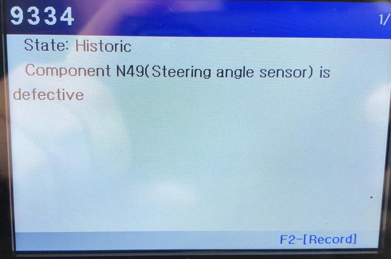

hi,
After a ESP inoperative Message popped up on the car I bought this machine.
I have taken pictures of all the codes I have found.
Pictures here: https://postimg.cc/gallery/2vr8xg1ju/
Would appreciate it if anyone could help decipher it ;)
Thanks in advance.

You've had a flat battery.
Looks like you may need to recalibrate the steering angle sensor although it's an historic error. There don't appear to be any current errors so clear them all and see if anything comes back.

odd, what's the code for this model? not based on the S class of this era? non of those code look familiar to me

look at readings of the ABS sensors....
the car will be drivable… it will be the same as any vehicle that doesn't have it
its a stability thing to help you not lose control in extreme circumstances, drive sensibly and it will never come in to play

just took another glance at some of your fault codes in the first post... most are probably gargbage but if this is still there highly likely to be the cause and or linked... this is a key part of the hardware than allows ESP to do its bit

I’ve had a chance to plug the machine in and these are all the codes I could find.
https://postimg.cc/gallery/hxxjm0ey/
Also worth mentioning I stopped somewhere for 5 minutes and when I started back up the ESP error vanished? Assuming it’s a intermittent fault?

You may have a wiring problem around the steering column, a clock spring, or the steering angle sensor itself.
As for it resetting, I replaced a front suspension ball joint a while ago and had the ESP warning up until after I had the car tracked again and it then took a while before it finally reset itself after a few miles and restarts.
