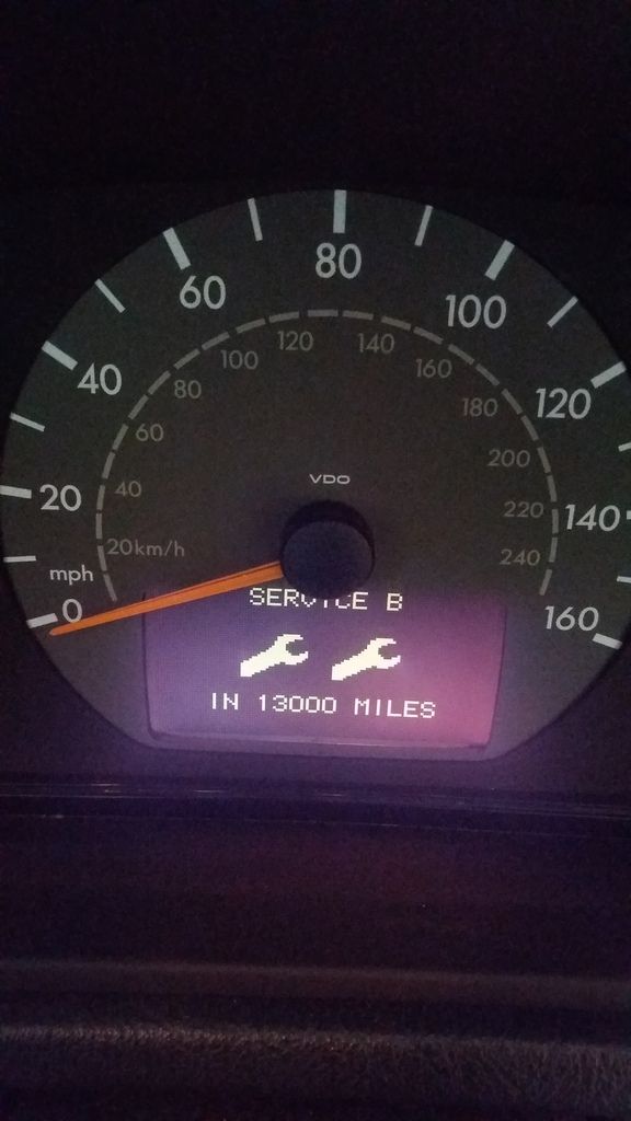

I have conceded defiet on resetting the service light and gone to see my local indie. He's not MB, he's Audi but assures me he has the correct lead.
I told him my story, he smiles and says it can't be done via the buttons as I have exceeded the maximum limit. I am to take the car too him and he will reset it for me.
He also stated that you can't reset the service timer too early, you have to wait until you recieve the message.
I'll let you know how I get on.
Arudge
Arudge
Jun 14, 2016
753
247
Cradley Heath
CLK200 2000 Kompressor
  • #20
success:mrgreen::mrgreen:
Mark the Audi man has cleared that long overdue service message, for which i'm very grateful.
At least we now know that the B service exceeds 730 days can be cleared even if it does have to be done with software, i'd call that a result.
