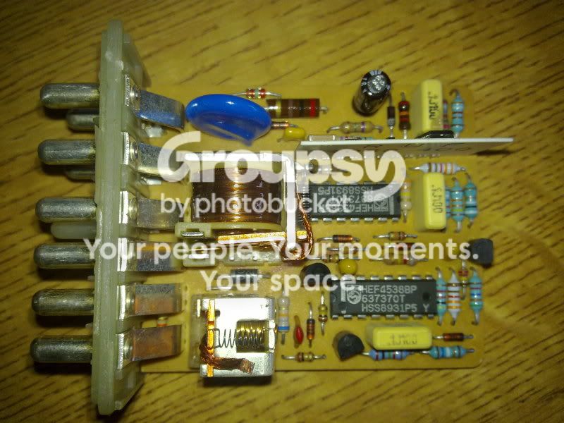

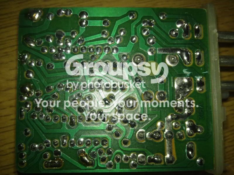

Hi,
Thanks for that, fuel pump relay is the problem. When the car wont restart there is no buzz. I read on a different thread to bridge pins 7 and 8 to bypass the relay, when this is done the car doesnt cut out and always starts.
I havent found a tread on how to repair the relay, will keep looking, or does anyone have any ideas. Here are two pictures of it with the case off, i dont know what i would be looking for if there was a problem.
Thanks again for the help
Alex Crow
Jul 9, 2009
10,677
61
Super Suffolk
W169, W124, w202, W203, KTM 250 EXC, VW T25 camper and a Polo in a pear tree
looks repairable. you will need to resolder the 'dry joints', i think i can see at least one in you picture but hard to tell you where it is without a numbered grid or something.
basically look at the side with all the solder on, and look at all the large metal pins that are in these solder joints. the metal pins should appear 'fused' to the solder and not have any cracks around them. the suspect looking ones are beneath the relay, the usual place as this can get hot and handles the current. if you scrutinise these connections carefully you will surely see which needs resoldering.
presumably the pcb expert will be along in a minute - probably even have beaten me :D

I use a magnifying glass to look at all of the joints, if there is a black ring around the pin and the joint then it is fractured.
If you are good at soldering then re solder them all,,that would take less than 5 mins, use a fluxed cored solder on every joint.
'You could ask a TV repair man to do it, or I would do it by return of post.
The pins on the relays are the main culprits

Another thing that can happen is that a printed track can go open circuit, when many MB lost the kick down function it was a open circuit track on this relay that caused that

Thanks for that television, i tried soldering a couple of joints (not confident enought to do every joint) which had a black ring around them, however they dont look any better now than they did before and its still not working. Dont know whether thats down to my solding not being up to scratch or further problems with the relay, hopefully its just my soldering :)

Many thanks Malcolm for whatever it was that you did, the problem with the fuel pump relay has gone, thank you very much. :D
164,070
401
91
That relay was almost new,,I cleaned and adjusted the contacts on the relay,,that was all. any way so pleased it is all working
