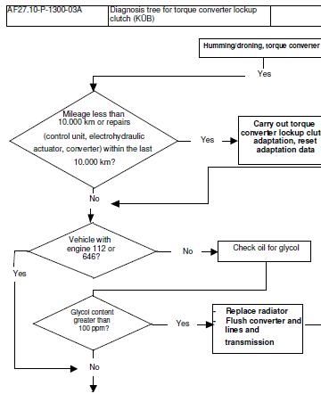

Hi Guys,
new to this Forum but have had over 20 years working and solving problems on these little beauties.
As previously mentioned, first check has to be the oil level - can only be done with a 'workshop' dipstick - gearbox tube is there but no dipstick !! Can be sourced outside of the Mercedes Dealer Network.
This age of transmission suffered from a variety of failures, normally would see fault codes refering to speed sensors. These are on the ETC plate which is attached to the Valve Body assembly - common failure but fault codes always present.
Also gearboxes had a problem with oil contamination - The main coolant radiator would split internally and cause Glycol (Anti freeze) to mix with the transmission oil. This causes a variety of gearshift problems and only seemed to affect vehicles fitted with 'Valeo' radiators. Remedy can vary, first is to get an oil sample to the Main Dealer who can carry out a Glycol test on the oil. Depending on the result it will lead to various fixes. Mercedes now supply a 'special' transmission oil that is meant to help the internal linings. In my experience does not make a long term fix. I supsect the oil and filter was changed previously to cover up the excessive Glycol content. 'Synical'
The thumping into gear could be an internal one way clutch fault. This is obviously a more serious problem. (Strip down of the box) Again this can leave debris in the oil pan and collects bits in the oil filter. Once again.. a 'cover up' with the oil and filter change.
My first step would be to get it to a Mercedes Specialist who has the STAR Diagnostic Machine and see if codes are present for the speed sensors, next get a Glycol test done and pray !!!
Best of Luck

Not to forget the oil contamination would be accompanied by a droning sound with engine revs at 1500 to 2000 RPM.
Also welcome from me too MB Car Tech :)

We have had a few 220 cars with the glycol problem, though this was not the same as on the others where a radiator manufacturing fault caused it

Malcolm,
Is it that the Glycol problem can happen on any radiator including all those fitted to C220 CDI? Or was there something else introducing the Glycol?
164,073
393
90
Malcolm,
Yes any combined rad can leak at any time, and this has happened on quite a few other cars other than the known 203,209 and 211 cars. Nothing else can cause it.
It a 2005 car - not that old. It's same as mine and I haven't noticed a lot of failures on auto-boxes.
The Glycol problem was fixed in 2003 with a redesigned radiator so that shouldn't affect this car.
164,073
393
90
Many 2004 and some 2005 cars have had the fault
rich.g.williams
Oct 25, 2009
836
219
Cardiff, South Wales
C200 Kompressor Coupe 2003
I suppose it could have taken quite a good few months for the radiator Glycol mod to get into the production line.
According to EPC the radiator fitted to my car at least is A203 500 05 03, A203 500 10 03 or A203 500 34 03.
Would any of these be prone to Glycol problems?

If you don't have the droning noise, then you don't have glycol in it.
