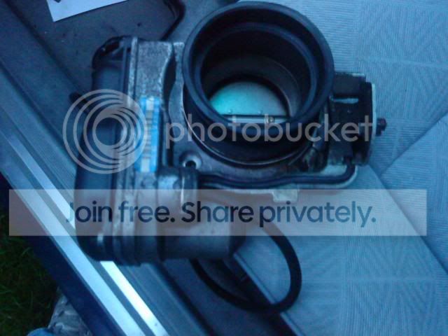

just checked the log book and theengine number starts 111 what's the air mass sensor look like?
would this be it?

you can read blink codes on this model. if you connect an led or ideally a power probe to socket 8. with ignition on, short pin 8 to earth (pin 1) for between 1 and 5 seconds. the probe will blink a series of codes if faults are stored - you have to keep going through the procedure until you get the first code again. to erase it`s the same but 5 - 10 seconds of earth. if no faults stored or you have cleared them it will blink just once. at least that`s how i remember it!! you will have the diagnostics available on your car. and i believe you have pms, so no air mass sensor - that`s your throttle body btw.
