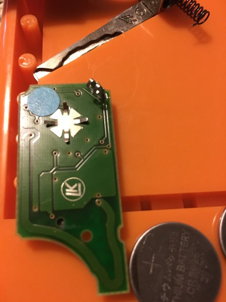

Well today I replaced my key fob case with a shiny new one. I took the battery cover off, opened the case, took my board and chip out, placed everything into the new case and fastened it all back together.
Pressed the unlock button and nothing. so searched how to re-sync the remote.
I have tried everything! tried the turn to pos. 2 then take key out, press lock and keep pressed whilst pressing unlock 5 times then press tailgate
Tried allsorts of combinations of the above process but still nothing.
The fob worked absolutely fine this morning before I swapped the cases over / took batteries out.
Looked on actual data on iCarsoft in the AAM and it says only key 2 is sync'd
I only have the one key for the car, no idea whenther the key I have is number 2 or 200!
I've tested the batteries with a volt meter and they are fine, even tried replacing the batteries just in case but still nothing.
I must be doing something wrong but I dunno what.
Help!

You might have knocked on of the sensor off the PCB, the are only about 2mm square. I can probably fix it, but it would take a few days in the post.

Thanks for the reply TV, where is the sensor located and I will look for any damage. only trouble is I can't be without the key for a while as I need to use the car, and this is my only key. I am pretty good with a soldering iron, but don't have an infa red system or anything though.

Take a look on the PCB there is a little white sensor on the thin end, one each side.

Think I've found the problem.
Pic 1 left hand side of the board, halfway up. I've looked at it uder the microscope and its squished / melted.
Does anyone know what it is then I can order the bit and fit it?

I think I may have found the reason why it's not working TV, if you look at pic 1 on the left hand side, roughly halfway up, just to the side of the microswitch is a broken component. I'm trying to find out what component that is, is it a surface mounted fuse or resistor etc, and if so what rating. Then I can source the correct part, and solder it in place, hopefully fixing my problem.

It looks like a ceramic capacitor,
but as to what value.........?

It's definately a surface mounted something or other! There are no legs like a normal capacitor, I have found 3 old keys from old vehicles but none are the same.
I need to pillage an old merc flip key to salvage the right part i think. Trouble is I aint got one lol
Hi Andy, I deffo put the batteries in the right way, There's a + sign inside the back plastic.
I'm tempted to bridge a single strand of wire accross the terminals, but I fear the resistance will be too low and I'll end up frying something else :-?

I think that you should buy a secondhand one on Ebay the same and swap the part over.
You can lock the car with the metal blade for now and the car drives.
Do not short that part out.
